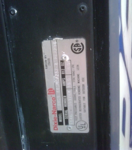

ID PLATE LOCATION: The following major brands represent 90% of soda machines manufactured. On these brands (Vendo, Dixie-Narco and Royal) the make, model and serial numbers are on a plate on the left side of the of the door located about 1/3 of the way up from the bottom.
If the plate is missing you can still find the brand name/manufacturer in alternative locations (see pictures below). Then you can get a good idea of which model it is from the DIMENSIONS (H x W x D) and CANS DEEP (number of cans deep machine will hold). For starters the major* model machines from the major manufacturers come in 2 heights 72" and 79" and are either 2 can deep (can only) or 3 can deep (cans or bottles). In most cases the model number represents the total capacity in number of cans. In some cases the same dimensions are for 2 or 3 model numbers but they are essentially the same basic machine, the only differance is the number of selections (more selections = lower total can capicity). Note: In some instances different sources gave conflicting specs, we went with the manufacturers tech docs first, then with majority rules. Also, dimensions are rounded to nearest inch.

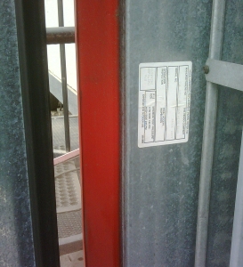

Here are alternative locations to find the Brand name/make (see pictures below):
Dixie-Narco brand on coin slot bezel
Vendo brand on coin slot bezel
Dixie-Narco brand on coin return bezel
Vendo brand on coin return
Vendo id tag on inside door frame
