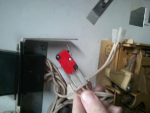

Daryl, thanks for the manual, so i have the amount correct to none, as you stated, shut off, then set and pluged in. now i put coins in just go right through. I get the light in each pad to go off when I push the filled indicators down or put cans in, but still does not dispense. there is a few loose wires at the top i have a picture of not sure where they go if anywhere, i did not unplug, not sure if the guy i bot from did when he showed me where to change the change? cant figure out why none of the shoots will dispense?

Daryl, thanks it appears as though the coin is set correct, now I set to zero, pluged in and all the quarters just flow through. seems like the signal not getting from the selection paddle to the dispense mechanism? what would cause that? also i took a photo of a little switch, not sure where it goes, again this worked when I bot it, literally hours before I moved it? any thoughts or do I pay someone to come check it? thanks again for help.

miktrov,
A several things come to mind:
1. If you set the price to zero the quarters should fall through.
2. That switch looks like it should be connected to a selection motor, check and see if all of your selection motors have all of there switches.
3. That switch might be part of a hack a previous owner did for some reason. In that case you need someone to check the wiring against the schematic for the machine to see what was done.
4. Is this machine now or was it ever a Coke machine?
If it was a Coke machine that switch and wires may have went to a special solenoid that changed back and forth from the first column to the second column on Coke machines because Coke was loaded into both columns and vended from one selection button (the first one). From the pic it looks like the switch was near the coin mech and upper part of the machine, this is where the Coke column selector stuff was usually located, parts of it may have fallen off.
