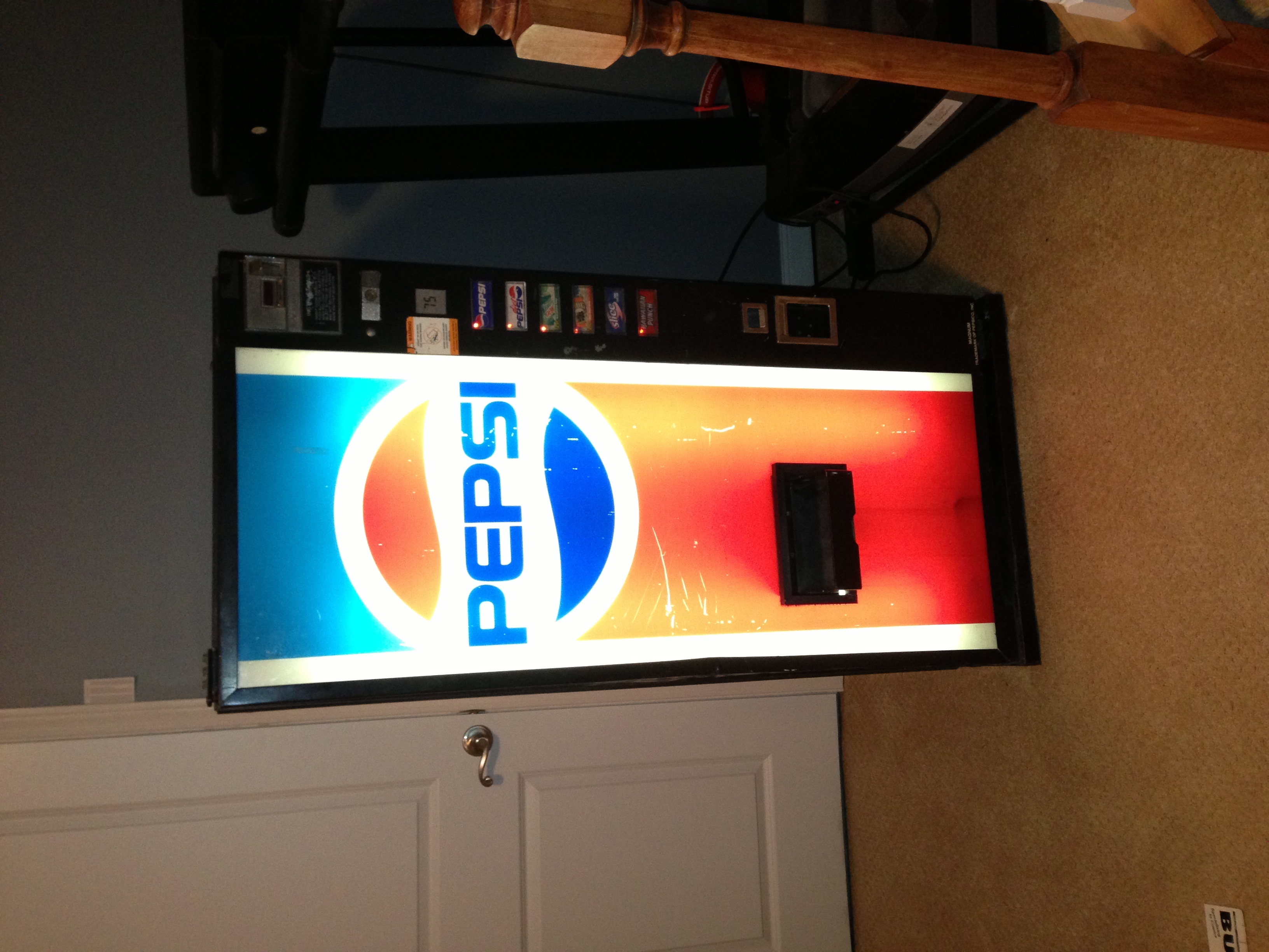

Hello, I am trying to figure out exactly what type of machine I have. I recently bought it for 200 dollars off Craigslist. It's a dixie narco and it says "magic chef" also do I think it's mid 80's. it has six selections with 3 being double wide and 3 single. The model number plate is missing so I am having a hard time figuring out what I have. It's a smaller machine 57x26 approximately . The thing works pretty good but I am having issues with jamming with the single wide slots. Any help at all is certainly appreciated.

It's Dixie-Narco model 168 or 180
Ewojtas,
According to our post "IDENTIYFING MAKE AND MODEL OF SODA MACHINES" at the top of this forum section it looks like it's a Dixie-Narco model 168 (your's is a 6 selection). You can download the manual for it here: http://www.vend-resource.com/book/dixie-narco-pre-s2d-series-90-vending-...
Also with single can selections jamming on a Dixie it can sometimes be the ejector strip, this post might be of help: http://www.vend-resource.com/forum-topic/dixie-narco-crushing-cans

Thanks for your reply frank, I think it is the 168 as well. The model # was completely ripped off the side. The ejector strip was bent conpletley up . I tried to flatten it out a bit but am wondering if I can just duct tape it down .(this is for home use only ) thanks again!
