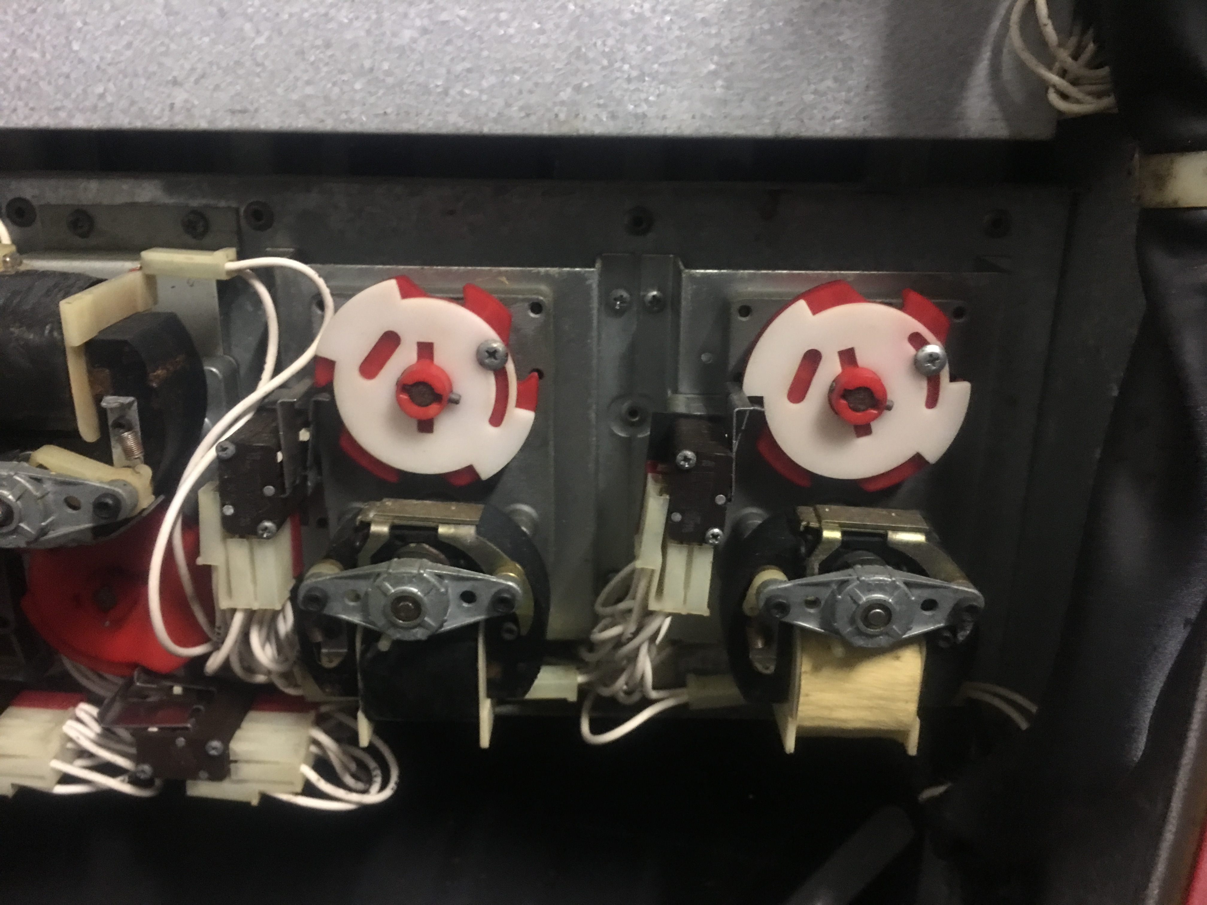

1) the 2 bigger slots (1 and 2) has to be selected twice to find (inserting money twice). watching the vend motor i think its not turning the correct distance and pressing it twice allows this. any insight will be helpful (i will attach picture of the vend motors)

Image icon vend motors and cams for 1 and 21.8 MB
Image icon image1.JPG1.95 MB
Image icon image2.JPG1.75 MB

The vend motors in your wide columns are set up to vend 12 oz cans two cans deep in the columns and I would guess you are trying to vend tall beer. You'll need to loosen the screw in the white cams and rotate them so that only two notches show in the edge of the cam for the motor switches to drop into. Then you need to adjust your rear depth spacers forward toward your products so that when the products are pushed against the rear spacers there is only enough room for your fingers to fit between the front of the product and the depressed sold out paddle.
